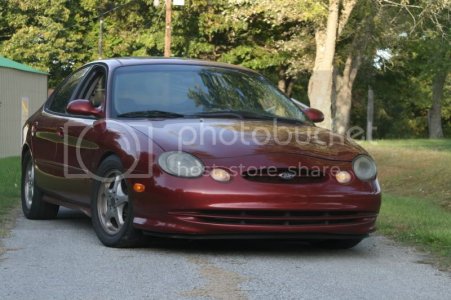

Roush springs, 24MM front and 26MM rear sway bars. I originally used the KYB GR2 struts, but they felt like crap. It gave the car a really floaty feel through corners. So I put in the factory non Sarc motorcraft and it feels alot better.

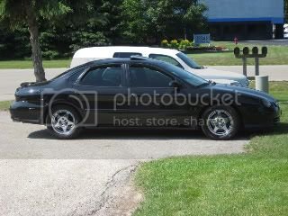

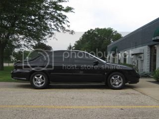

A great mod is air suspension. I have done this on my Gen III, they are still adjustable with soft to firm like the stock struts. I have it so that I can have it in auto, firm , or soft. Then on top of that I have the air ride fully automatic so it is always at a good ride hight with no ass sag and I can also lower it if need be. The car rides great and handles even better.
I don't know if you can tell, but the top image is at ride hight, bottom is lowered

Interesting. Continental parts?

no not at all and I'm running 245/50 16's, and the ride isn't anywhere to as rough as everyone says it is. I was kinda disappointed on how smooth the roush springs are, compared to by buddy's fox body mustang with the Ford Racing springs, my car rides like a cadillac.

I did it all myself, all computers, wiring, switches, etc. It was no easy task but all my vehicles have air ride. My 1991 is getting the rear baged this summer to help with the rear sag. I did my collage senior thesis on air and hydrualic suspensions seven years ago and in doing so I put together alot of information. That is when I first converted my girlfriends 2000 Taurus to rear air ride. From that point on it was what I had to drive, thats why my 97 is all four air. So is my wifes Navigator (stock), my Dodge which I did in highscool, and 91 is in the works.
