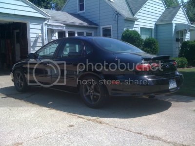

I have three different sets of good wheels. One set brand new and never installed. Pacer something or other. The Enkei Wheel Or52 on the car now are great looking IMHO. Also have some rims with track tires that don't look too bad. A bit flashy with fake Allen heads to simulate a two piece rim. Most of the Volvo Borbets look good but are heavy.
