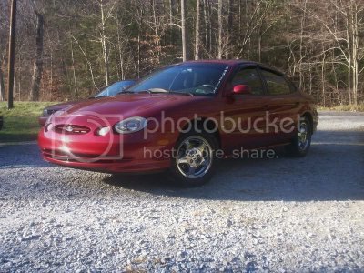

I think the car handles alright as it is. I have never pushed it very hard at all. I thought the car stopped well, too, that is before I replaced pads and rotors because they were grinding into each other! The biggest thing for me was the knocking over uneven road, which was rectified by end links and lower ball joint. I guess what I am trying to say is that I want to take away the gap between the fender and tire, you know, the gap big enough to fly a 747 through? I want it to sit a little lower, but have the car ride as well as it does now.

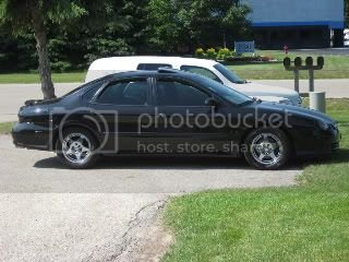

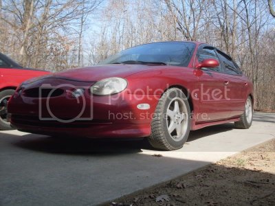

You want this:
100 0688
To get to this, correct?:
Sideup

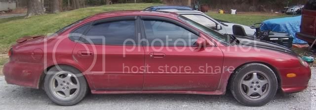

I'm running Eibach lowering springs with KONI adjustable struts. ShoSource says they're working on an alternative as the Eibachs are no longer being made. I've never run lowering springs with the stock struts so I have no input on longevity or ride quality. I run the KONIs at full stiff most of the time and I don't have a problem living with it.

Haha, yeah. Looks good. That's about right, with the exception of a car wash... Drop springs with Koni's means no adjustability for ride height, correct? I do like how low, but rear is still lower than the front. I would hate to go through the time and money only to have it not match. I have always used adjustable coilovers or gotten the look I was going for with drop springs. The rear of my car already sags lower than your sock picture,but sure its because of old springs. Yours looks like a 98-99, so you did not have to mess with SARC, right?

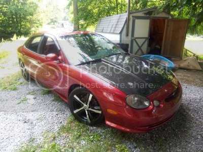

It's a 97. I just unplugged the SARC from the harness and pitched the struts. That was spring time before it was warm enough for me to wash it anyway.
The rear is the same height as the front. The wheel well isn't exactly center on the wheel and is smaller than the front well. I can also move the strut up in the knuckle if I wanted, but I used the stock mounting locations.
No dirt since you guys want to be jerks :p

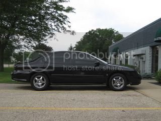

A great mod is air suspension. I have done this on my Gen III, they are still adjustable with soft to firm like the stock struts. I have it so that I can have it in auto, firm , or soft. Then on top of that I have the air ride fully automatic so it is always at a good ride hight with no ass sag and I can also lower it if need be. The car rides great and handles even better.
I don't know if you can tell, but the top image is at ride hight, bottom is lowered

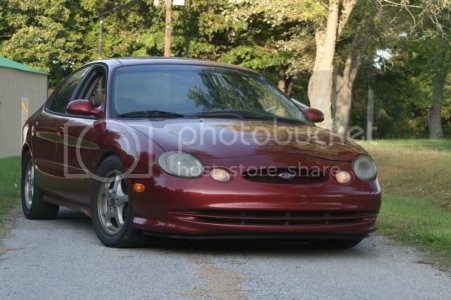

OEM motorcraft struts from a 2002 Taurus SE, Eibach springs, and rear SFBs on all 4 corners.
SDC10733
SDC10732
Ride gets a little choppy over really rough pavement, but the handling is far improved over a SARC equipped car (yes, I've driven a good SARC equipped SHO since I did this to mine) even with the snow tires. There's no perceptible body roll through on ramps, and I've yet to get the tires to howl, and it's not without trying.

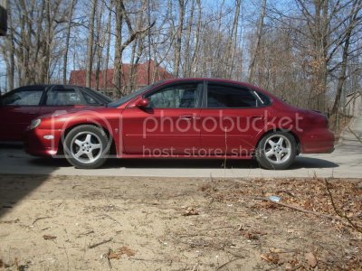

Roush springs, 24MM front and 26MM rear sway bars. I originally used the KYB GR2 struts, but they felt like crap. It gave the car a really floaty feel through corners. So I put in the factory non Sarc motorcraft and it feels alot better.
