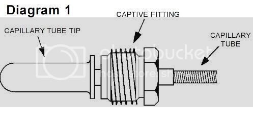

Any suggestions on how to incorporate a mechanical gauge sender into the system without losing the stock gauge?
Gauge uses a large calipary tip:
GaugeCapilaryTip
Heater Hose perhaps? Or a T at the temp switch? Will a T give accurate readings if the probe isnt directly in the stream of coolant?
Also is a T acceptable for the Oil pressure Sending unit and the aftermarket mechanical hose?
My experience with temperature sensors installed in various T arrangements is you will not get an accurate reading. it will read lower than actual.
I would install it in the block drain provided the probe does not block the passage.
