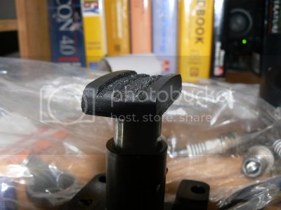

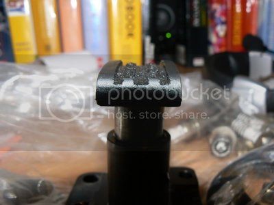

Hydraulic.. some have luck cleaning them out.. I just had too much wear on my pads and had to replace mine.
P1000526
P1000524
There is actually 2 different types of plastic I've seen... this is what I replaced.. just a little too chewed for me to put into my rebuilt shiny heads.. lol

Ah, you just wanted everything inside the engine new, since the block was new . . . .
