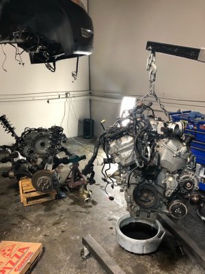

New engine is in! Going to change PTU, ATF, oil and coolant tomorrow and then start her up! Fun project for sure, total time actually working was about 12 hours. Got the engine mounted on the subframe, installed in and wired in about 3 hours.
