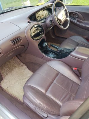

- All RHD SHOs had a purple interior...

I don't know why, but I find the right hand drive exciting. Interesting it had the pull lever E-Brake vs the foot version found on most I have seen here in the US.

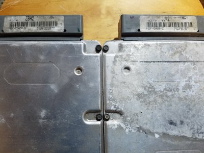

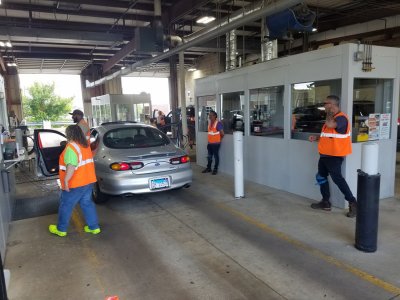

Let us keep the information on this special SHO in one thread. Today's topic? Emissions testing.
I believed the car to be exempt but Illinois believes differently and summoned me for annual emissions testing.
I failed technically because of unsupported monitors. I do not believe this program was modified, but the PCM is one I have not seen before.
Code is ZBA2

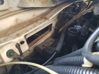

Also, being right hand drive, the wiper motor is directly over the computer pocket in the firewall. Should be a fun removal.
I have a spare JJK2 PCM that I will try to fit to the car once I verify the plugs will mate.
Will get back with a picture or two and some feedback after I get as far as I can on this project.
JJK2 is what I have in one of my SHO's. I wouldn't suspect there would be any reason the right hand drive would not work with the ECU.

JJK2 is probably the most common 1996 PCM that I encountered during my camwelding years.
Getting to this PCM was a huge PITA, but I got it. Comparison was nearly identical down to 1 digit on the part number (see pictures).
Also, when at the emissions testing site, the car basically shut the place down - everyone working the lanes came over just to see the spectacle. We had a lot of fun but the lines started backing up pretty fast.

Alrighty then !!!
Apparently the wiring looms are compatible. Car starts and runs. Shift through gears acted normal. Have not had a chance to drive but X Cal programmer only pulled a P1000 code after a five minute run.
