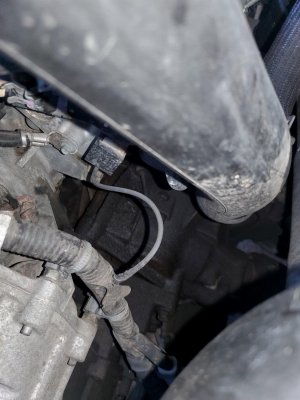

Well... thats not what I wanted to see when trying to get a look at the turbos, guess ill be draining and filling the ptu this weekend and we'll see how long it lasts. @SM105K 4df8f4cc996b0659cd278c38b95ce854

It is making noise?

It is making noise?
I'll go for a drive in a bit and see, thats all fresh so i think i just went a lil overboard last night and got her real warm thats why im gonna go ahead and drain and fill asap hopefully avoid too much damage

Just watch it.
