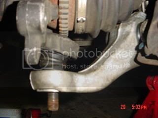

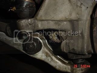

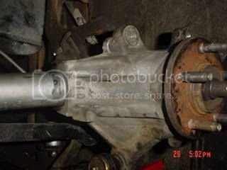

:omg::omg:Well actually you are all wrong.. IN a way..
The knuckle will bolt on to the strut with no problem, and like Jimmy Boy said that the Gen 1-2 Arms have the ball joint built into them and fit into the old cast Iron Knuckles of the gen 1-2. While the Gen 3 Knuckles have the ball joint in the hub its self faceing downwards..
So if you tried this like this, it would look like a home video from st louis sho family reunion:salute:
Now I started some work before I finished the first subframe conversion in 03, useing some lincoln control arms (forgot the year) they look very close to the Gen 1-2 style but they are a tad bit long. I did muscle one into fit the the camber was so far off that you could not make it up some where.. after about three weeks of trying to figure it out so it would work properly I gave up and just made the Gen 3 conversion..
Plus IIRC I could not get it apart so in normal kirk fasion I burned it off the car, what a huge pile of aluminium goo that made.. Ill search for the pics I have of it and send them to someone that can post it for me.. Sure I made the first 5 Gen 3 conversions and yes I cant figure out how to post a pic!!!
it could be done, if there was a pro ay aluminium welding. But Im not sure I would trust it.

pics sent to MR.A and St Louis SHO to post.
actullay looks better then I remembered.. and more and more I think of it they were 97 conti arms... they are expensive if you guys want to play. or were anyway.
