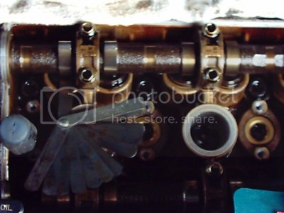

got some shim measurements ..........pretty depressing
all my intake and a handful of exhaust failed to qualify .
