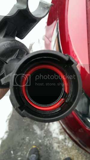

Once that obd2 diagnostic scanner comes in I'll have a better idea. You would think when I took it to the dealer they would have checked for something loose.
 5845980091141703402 13937902668068816 zpsbzgmjo1n
That o ring was broken on diverter valve (I'm assuming that is what it is) which they replaced that and the whole tube. But looks like something else is the issue.
