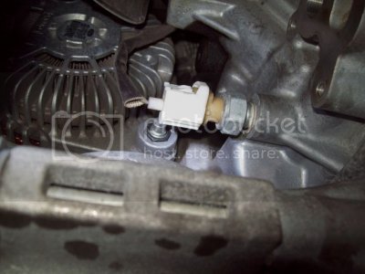

As to where the engine oil is coming from, not a clue other than the oil filter or oil pressure sensor (I think that is at the rear of the engine/firewall side?). You'd think that would be pretty obvious once the pan comes off ...
9,045
4,390
Ok, I found a pic of the oil pressure sender unit that bpd posted some time ago, looks like it is very close to the alternator ...
004 zpsd760926f
