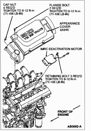

As Ian said, sounds just like you'll need to replace the COP (coil on plug) unit... these cars have no spark plug wires BTW. If you're going to change all the plugs and you've never had the top part of the motor off on the car, set aside the better part of an afternoon and look at the instructions on v8sho.com. I think a majority of people are simply using Motorcraft plugs... either AWSF32FM or AWSF32C.
If all you're going to do is replace the one COP unit, then just remove the appearance cover and the IMRC control unit and you'll have full access tot he front bank of plugs and COP's.
