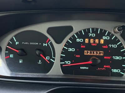

Less than 100 miles, since fill-up, I already have about 1/2 tank left and I don't go anywhere.
