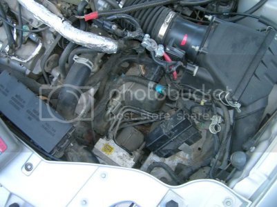

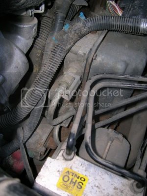

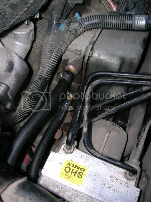

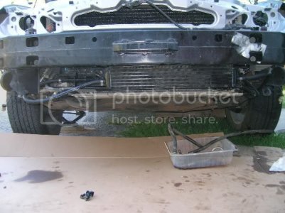

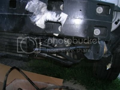

Is there a step-by-step tutorail anywhere I can reference?
Or possibly someone who has the time to work one out in full detail; including all needed parts, as I am not able to get under my car as much as I would like to know more of the basics than I do.
Im no idiot, but when you say drill a hole into the frame, which part are you talking about?
Sorry, if I seem like a fool, but work sucks right now and my head hurts something vicious the past three weeks...

I know there has been debates about this, but if you add an aux cooler, PLEASE keep the cooler on your radiator hooked up as well! There are many benefits to this cooler, that's why every car with an automatic has one from the factory.

I have not found that to be the case with the GEN 3. All you are doing is adding heat to the engine cooling system.
There is no appreciable heating of the ATX fluid from the radiator when the temps are cold as the radiator ATX cooler is on the cold side of the radiator. In the summer it is only dumping more heat into the engine cooling system.
