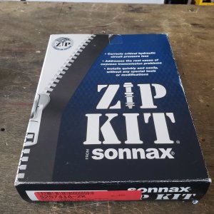

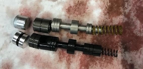

SP precision is a remanufactured trans....nothing special about it. Same goes with the Level10 trans. They call it "Bulletproof" but when pressed, they won't divulge what was done. Thats because there is NOTHING that can be done. Unless they are making custom billet clutch baskets or something, which they aren't.
The friction plates still aren't out yet, so that isn't being done. Outside of some WPC treatment or Cryo...there is nothing you can really do.
Install the Sonnax Zip Kit and do the larger snap ring on the 3-5-R drum....that is...it. Everything else is simply a factory refresh.
I don't care what anybody is saying, there is literally nothing that can currently be done to these tranmissions outside of one-off billet parts.
I'm pretty tired of these places claiming there is something special they are doing.
@802SHO has something in the works that might be a step in the right direction.
As for the trans in the different platforms...they are 100% identical. Be careful on which final drive you get though...the Explorers came with a few other gear ratio options (don't even entertain the idea of changing them...not much can really be done there).
Thank you for posting that information. I was just looking at their site over the weekend and admit I got pulled in on their claims. Glad I didn't go any further. Figured it was to good to be true.
