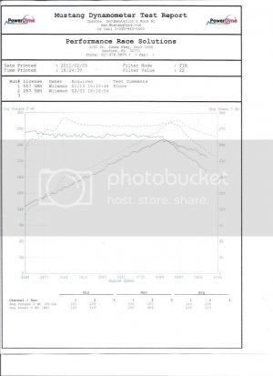

So I finally had a little time to work on getting my scanner working again and was able to scan the dyno sheet. Obviously solid is stock and dotted is tuned.
Tuned Dyno
P.S. The guy who ran it on the tune didnt get on it till like 3K which is why its low and jumps like that.

Mustang dynos tend to show much lower (possibly more realistic) numbers than Dynojet. Also, that sheet does not show whether those numbers are STD or SAE. SAE takes into account environmental factors such as temp, elevation and humidity. So those numbers tend to be more realistic as well, or at least better for comparison purposes.
In any case, a peak rwhp difference of 36 from stock to stage 4 seems pretty low. Was the car tuned with the "modified" intake? Changing the airflow characteristics of the intake can have a dramatic effect on how the MAF reads the intake air.

Livernois Dynojet is load bearing....also these cars dont use a MAF so the intake shouldn't matter.

Those numbers do seem low..is that Stage 2 or 3? or is it 4? I know when my car was tuned the humidity was outrageous and it was like 100 degrees outside and I'm pretty sure my numbers were quite a bit higher than that. I'll try to find the copy of my sheet and compare and make comment.
Most important though is how it runs..not so much the numbers. I've ran much quicker than you with the same tune as well. Pretty sure it's not elevation there in Florida, maybe it is just the weather.

This dyno run was with the stage 4. When I got the tuner I went straight to stage 4 and haven't changed it sense. Aside from the numbers it does feel like it's running hard. It's was about 70 degrees during both the stock and tuned pulls which happened on the same dyno just a month apart.
