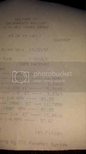

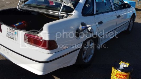

So me and my brother took the SHO to Sacramento raceway last weekend. The car is bone stock with all season tires and all, EXCEPT a 100 shot from a zex nitrous kit and 100 octane ERC race gas I'm extremely happy it ran a 13.99 and I felt it had even more but launching on street tires was tricky. So anyway I figured fugg it and bumped up the spray to 125 and it wasn't my brightest idea haha pictures are below. Still pulled a 14.2 with the melted plugs haha

Haha thanks yea I had a few runs where I trapped higher MPH my first run I trapped 99.6 but ET was 14.10 and another run I trapped 100.49 but again ET was only 14.16 those street tires were killing my 60' I'll take the car back to the track when I get the quife(or how ever you spell it) and center force clutch installed and some sticky tires
