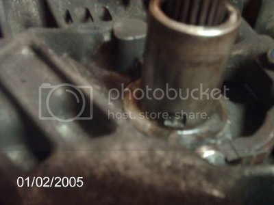

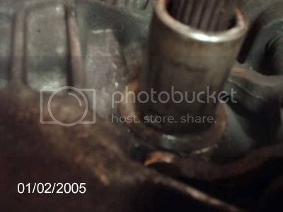

Bent the little tabs out completely, sleeve still wont come off. Pulled on it, twisted it. I need some ideas on how i could get it off, really on a roll with the car and if i can keep things movin tonight it would be awesome. Thanks

Score it with a dremel, peel it off with a screwdriver and vise grips.

Die grinder + cutting wheel , be really gentle with it just to score it. Then hammer + screwdriver in the score.

It's not to hard, may seem scary but even if you cut into the aluminum case a little the new sleeve is going to cover it up. It's the easiest way to remove it, trust me. Do not use a torch because you run the risk melting the output shaft seal. When I replace mine, I use a little loctite to ensure it's not going anywhere and I think it's a slight interference fit.

Same here. a dremel with a cut off wheel. don't go too deep.
Before you put the new quill sleve on , use GREEN Loctite.;)
