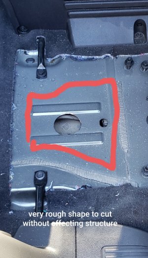

Yup, I lifted the carpet and there is about a 1" drain port with a rubber plug i pulled. I used my boroscope to see what's under it and I can see the top of the fuel hanger. So I cut a 2.5" larger exploratory hole. I have some random rubber cap/plug I got from who-knows-where years ago that I can plug it up if it doesn't work out. But after looking at it, i know i can cut a roughly trapezoidal shape out. I have access to commercial shears and presses so I can easily make a plate cover for it when done

So here's what I'm looking at, I know this doesn't effect you guys at all, and I'll end up posting this on Explorer boards, but I'll be cutting that shape out and I did some measurements. I'll be able to access the fuel hanger through it and not effect any structural points. The cover I'll make will be thick and will seal, but I'll also press some ridges into it to strengthen it as well.
But this will go a long way toward giving me easy access, especially when I get to my PWM surge tank project I've been working out...
