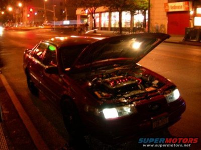

14th between 2nd and 3rd avenue was as far as I made it. :frown:
It turned out to be a dead radiator fan, but the engine got waaay hot. Needle in the red, and the overflow bottle was spewing coolant like no one's business. Luckily, it never seized. I had it towed home (to the tune of $225 :oogle:) and today I completely backflushed everything out of the coolant system.
It starts and runs ok (not that I can go anywhere until I track down a new radiator fan or fan motor), but is there anything I should keep an eye out for that may leave me in a bad way at some point?
