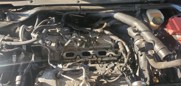

Here we go again, on the way to work cylinder 4 injector decided to exit the chat. Not even 2 months later and I'm going back under the intake, this time I'm doing the 5 remaining injectors. Budget and time still being an issue going with the standards again. Posting for 2 reasons, #1 @SHOdded you were right (not that I doubted that) i shouldve done all 6 and wouldve if not for the budget at the time. #2 anyone who goes down the injector rabit hole dont do what i did, just replace all of 6 injectors. My car is at 118k and they're failing one by one.
Inspect and clean the valves this time :) The Ford gods are telling you something.
I will definitely be checking and cleaning valves, and not sure if it's the Ford gods or the car is just possessed and wants me to be divorced lol "honey, I need to spend another $600 on the car you don't like" I need a solid 6 months of no issues to get any credibility back for the car, she just bought me tires out of her mattress fund a month ago lol

Valves were checked, kinda black, but not caked I could see the shape of the valves, I hit them with some CRC tb cleaner and then some CRC valve cleaner and slapped it back together. Found out cylinder 4 was changed at some point, 5 and 6 were light brown and almost corroded looking, but now all are less than 2 months old and she pulls HARD. When I saw the rail pressure hit 18,000 I bout had a heart attack but realized it was in kPa lol. All stats are in range and other than an initial stumble at start up she's good to go again.
