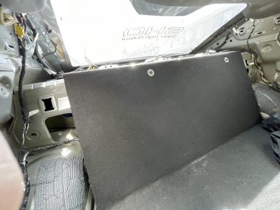

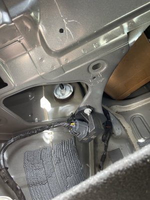

Yea. Just pull your seat forward and its right there. I think theys 10mm. My back seat is a little different. It didnt make a difference, I remembered i changed it out over covid. New one and one already installed had same numbers. I still put the new one in. I want to grease and check the torque on the ad mounts and the driveshaft. Since having it off for ptu swap. Might be adding in not need vibration. Also thinking it may be the msd coils also
