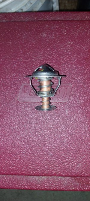

Great info, here is a picture of the thermostat I received. It's quite possible this particular thermostat is from other sources. There's no name brand on it.Screenshot 20220222 112842 Photos
It's the airbox side. I wasn't aware there was any other coolant regulating devices Elsewhere on the engine other than that one. What am I looking for below the alternator in the way of thermostats?
I considered the possibility of there being an air bubble in the system or even other cooling problems. So I had the system chemically flushed and vacuum refilled with the latest Ford POAT coolant at a radiator repair shop. No difference and the repair shop said the thermostat was operating as it should be.
I also considered the possibility that the coolant temperature sender unit was out on its reading, but the CHT sender unit was showing high temperature as well.
That's the point when I started trying different thermostats and found that the OEM thermostat kept the lowest temperatures.
I have a 150 degree thermostat to try out as well (not LMS). I kind of suspect it will be too cold to get past they closed loop parameters. I won't be testing that one until summer though. Too cold in the Great White North (props Bob n' Doug) for that sort of thing this time of year. LOL.
Oh one other thing. Well running temperature comparisons between the different thermostats in a heated *** (p o t) of water. The supplied thermostat, failed closed during one of the tests. The Pressure Vessel the wax motor was in, started expanding the two pressed together halves. So it is a good thing that I had pulled it. I left this information out because it really didn't matter and it can happen to any thermostat.
