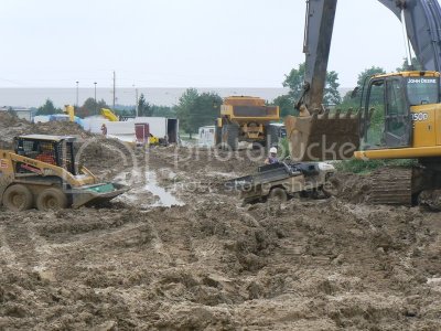

It was also time consuming getting this retard outta the mud. Why he tried to drive it thru there, we will never know. I swear he's still back in the 70's.
P1020291
Good thing we had that big excavator around, because I wasn't getting muddy. Anyway, if the rain lets up, I might get it out by the weekend, crack it in 1/2 and let you guys decide on the outcome of this tranny.
I see it here all the time. We refer to it as, "the Bubba-factor...." (not to be confused with the "O'Reilly factor")
