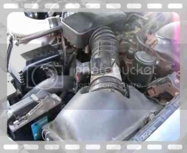

I found my noise... jacked the car up, ran it thru the gears to get it up to 30 in 3rd, then turned it off. I can stop the wheels but I still hear this spinning. Now what is it? Don't say the D word, or SHOboom. :(
Th P1020211 1
I think I broke my rear motor mount, you can see it shake a little, and this is with no weight on the wheels. Maybe a pp bolt loose? I didn't look but the accy belts / crank stops when the key is off dosent it? Couldn't be the PP spinning.. and I only know of one thing that 'rolls' like that. But would rather have expert help on this one.

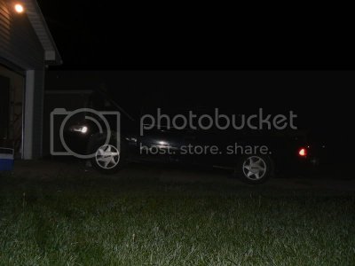

Well here is the update and one question. That bearing there by the S in supermotors... how many bearings are there in the tranny like that one? I did manage to crack that fill plug open, and my friend didnt stop out with his drill bit and my new drain plug, so I guess I'll go get one tommorow. But I did feel around what I could and didn't find any metal at all, just dark fluid. Also, there wasn't anything "pooling" near the fill hole, but then again, look at the angle of the car at the moment.. :)
P1020220
I dont think there would be anything near the hole would you? :) Not within 'pinky finger range' But what if, my fluid has just gotten to the point where its 'low'. I can't tell you when its been actually changed. It was "Supposed" to have been changed when I had a clutch job done years ago. But with some of the 'hints' and 'clues' I had of their work under the hood, I wouldn't put it past them not to have changed it. And if they didn't then god only knows how long its been. So could low fluid have smoked a bearing in there somewhere maybe? Or do I have a pin 1/2 way out? I'll know better tommorow and get some good pics of the fluid for you experts to diagnose. :) Thanks again guys.
