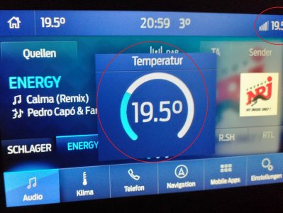

2015 SHO. Anyone know how to fix this issue in forscan? Any change in temp/fan does not pop up in the center of the screen like it does in my wifes 2018 explorer.

Those features only work on vehicles with CGEA 1.3 networking. The 16 up explorer has it, your Taurus does not.
