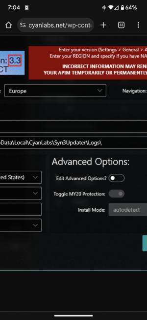

Ok got ya - 2019 has v3 - I needed to update got ya. You select My20?
1000002604
kryptto
Mar 24, 2023
3,201
2,075
South East, Florida
Honestly cannot remember… what’s MY20?
Well if it wasn't checked it would of bricked. There is now protection to make sure I was reading. So did you upload the logs when completed? If so you can ask for assistance. Did you take a pic of before versions and now the current?
