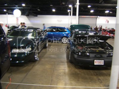

That's my SHO on the left that mysho1 posted in the picture. I am running 17 by 9 cobra r chrome replicas with some huge toyo proxes t1s tires. The ride is fine I just needed to completely shave the rear wheel wells cause I was rubbing the fender everytime I hit a bump. They look really nice.

Here's some pics of my SHO, can't wait til it comes back out for the summertime!!
Like 2 more weeks..
