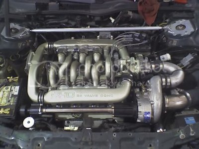

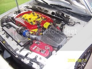

Ok here so you get an idea!
This is the kit offer by FPS!
Photo 090205 001
This kit a similar to the one offer by TexanTony
I personally preffer the one offer by TexanTony, but thats only my personal preference.
which system makes more hp or is better overall??? is still A mySteRY!!
he also has the intercooler version!
100 0555
Good Luck!:thumb: :type:
Jean.
Photo 090205 001
100 0555
Jean.
I find it interesting that all three of these SHO's still have the batteries mounted in the engine bay and not in the trunk. With all of the extra piping and relocation issues, it seems like a no brainer to put it in the back. Working on an NA SHO with the battery in the trunk is so much easier. The same would be true of a blower SHO.
There is no question that the most HP has been seen from the SHOShop style kits, not that it's a better design, but it has been much more prolific and installed on many more cars, ran, tuned and tweaked by many more people.
The reason is that it is an actual "bolt on" kit that most people can install without too much trouble. Tapping the oil pan for the S/C oil return is the only thing that is not truly "bolt on".
This kit also allows an easy installation path for a standard aftercooler core, although that would not be a "bolt on" affair.
Or course tuning is a whole other issue.
Several SHOs have dynoed at over 500whp with these style kits (not that it's a safe thing to do!), and I don't think anyone has come close with the FPS kits. I think this is because most "do it yourself" mechanics choose this kit (or pieces of it) for monitary reasons over FPS, not to mention the fact FPS only sells their kits installed, and you would have to transport/drive your car to them from wherever you live in the country.
Of course, if FPS is the only one that installs their kits, then you have great quality control versus sending a kit to some home mechanic where results may vary.
Not many people have more experience with supercharging SHOs than Tony. He has massive experience not only in installing (and constantly improving) kits, but also driving and racing the cars themselves. Bottom line: He knows what works, and how to get it to work. All from practical hands on experience.
You can not go wrong having Tony sell and install your S/C kit. I also think Tony would be more willing to make a crazy HP setup than FPS.
FPS is a good option as well. Just depends on what you want.

South Jersey
I've driven the FPS setup a few times and really liked it. It's easy to tune and the power response is nice and linear. It may not make the most power but how much power can you get down to the ground in this car without shredding the tires anyway? The car was pleeeennty fast as it was. If I were going to SC my car, I'd look for an FPS style setup or make my own. I thought that Doug was now selling his setup as a DIY kit?
