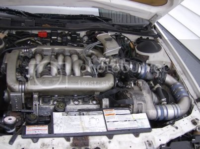

I'm running a home made powerdyne setup. It works great. If you buy a kit from a Mustang, and you are really handy with fabbing up brackets, you can make it work on any car.

How are you driving it? Do you have a photo of the whole drive belt system?
How much boost?

Well, I'm not certain which Mustang, but I assume an early 90's 5.0.
I drive it pretty much normal...Just cruising around, it likes low RPMs a bit more. I find myself downshifting less than my N/A 93MTX.
It starts to build boost at about 3000RPM. By 5000, it's at about 6PSI. The max I've seen is 10PSI.
It's pretty drop dead simple, actually; a lot easier than fabbing up a turbo (sorry tim).
Everthing needed from the shaft stock, to the coupler, to the bearing, to the blocks of metal, can be purchased on the internet (eBay FTW).
Making it all work is up to you.

I wasn't asking how heavy your foot was, I was asking how you drive the supercharger - how did you route the belt and do you have a photo of that?

The belt goes under the alternator and over the S/C and back to the tensioner like normal.
And it's a 57" belt...not a 61...
