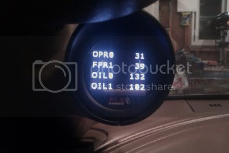

I have a dual gauge for sale, pressure and temp see classified. Also SHONUT sells PLX gauges you can put 4 in 1 or even more depending on what style of gauge you want. Here is the PLX I installed.
IMAG0163
I have it set for oil pressure fuel pressure oil temp and trans temp.
IMAG0163
Nice gauge!
A couple questions.. Is this the DM-100? Can you program the color of the reading to change (to lets say red) when it reaches a danger zone? When you reach the danger zone, can you program it to blink or get your attention somehow?

You can get it to flash when it goes to a certain range yes not sure if you can change the color at that time or not. But you can change the colors of the display to what ever you want. I believe it is the 100
