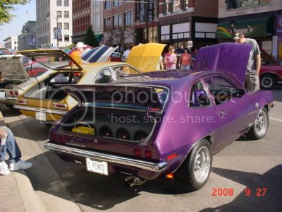

Okay, So I am a little negative on this install.
How heavy are those subs?
You guys are aware that subs do not have to be aimed toward the interior compartment to work...

I'll preface this with the fact that I used to be an acoustic engineer designing speakers for Harman. I am plenty aware that subs do not NEED to be aimed towards the interior compartment. It's also worth noting that you do not need the subs facing backwards in the trunk.
In the picture you showed is that those subs are in a box (looks sealed but might have a port somewhere). In the OP do you see any sort of box around the subs? There is a difference between Infinite Baffle design and a boxed design. For infinite baffle you don't need the subs aimed into the interior compartment but you do need something that will separate the front of the sub from the back. In this case, the OP has used the trunk area as that separation. One could also use a body panel as the separation if they wanted. What you cannot do in an infinite baffle design is stick the sub in the middle of the trunk facing backwards.
Bottom line is that the key difference here is in infinite baffle vs boxed sub design.

Yea.... Not really where I was going........
More concerned how much weight the rear shelf can support?
A bunch of miles and lots of potholes with what looks like some hefty subs could cause some serious affects on sheet metal.
Maybe something like small fender washers and bolts but definitely NOT sheet metal screws.

It might not have been where you were going but it was addressing the statement and picture about subs not needing aimed into the car
I guess that's each to their own. I wouldn't have an issue with adding a little extra weight spread out over the area of one of those wooden panels. Having designed speakers we've hung speakers and boxes from sheet metal and it's passed all the test required by automotive manufacturer (Toyota was the largest consumer for our plant). After seeing this install I might pull some speakers out of storage and do something similar. I don't want to give up space but would like a bit more on the low end.
Geee//
You did not even comment on my custom taillights...o_O
