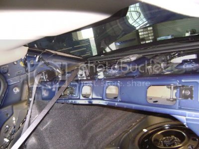

First I removed, the rear seat bottom, side bosters, all trim on sides and up to drivers front kick panel, all trunk linings, and the rear deck cover panel.

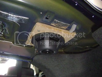

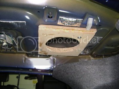

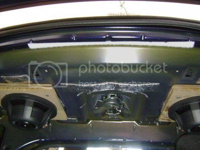

I cut two more boards and then cut the 8" opening from those. I glued the two boards together so I had 6X9 opening on top, and 8" round opening on bottom. A good size bead of silicone sealed the 6X9 board to the bottom of the deck. Subs were then installed from bottom up onto the new 8" opening.

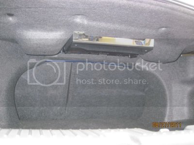

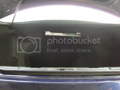

I cut an additional board to sit between the subs on the bottom of the deck. This is what I used to mount the amp to. The amp was mounted AFTER i replaced the top trunk shelf cover that covers the subs. This is not a great picture, but this is with the trunk pieces all back together and the amp hanging nicely in the center.

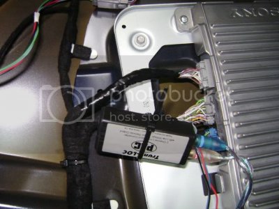

I installed my Line Output Converter to the rear speaker outputs on the amplifier. I did NOT use the subwoofer outputs because I wanted complete control of frequency ranges. Had I used the sub output, I would be limited to the frequency range of the factory subs. Here is LOC installed.

Everything is hooked up and works properly. Opening the trunk now looks virtually the same as before with the exception of the amp, which takes up no trunk space. The sound is leaps and bounds above where it was with the 6X9s. I can now FEEL bass! I still have some work to do dialing in the amp gains with a DMM, and setting the frequency levels, but right off the bat I am very pleased with the outcome!
