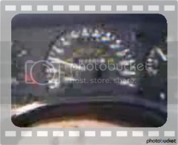

I guess this is the only way to describe it
Click on the pic to watch the video (sorry for the huge and crappy-ness. Camera phone)
Th vid092706 1
Any ideas?

i know, 0-140 in under 1 second
Wonder what a 1/4 mile time would look like at that speed.

The speedo head needs oiling, its starting to stick. You will have to remove the speedo and use some very light oil on the bearing near the clock spring.
that was my guess. I did 130 last night (oops) so i think that just pushed it over

I had the same problem sent in the speedometer to be rebuilt but didn't work. Sent it back with the cable from the transmission and found out the the cable was just worn and had to be replaced. works fine now.
