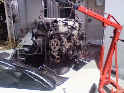

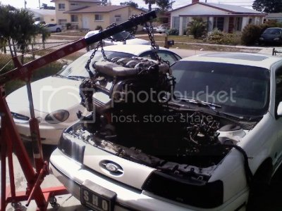

Anyways, got all the stuff disconnected from powertrain, just got to take out tranny mount bolts and up it goes. I'll get some pics of it and post it here later today or whenever I get it out.

Its alittle tricky pulling the tranny from the top so be careful you don't bust the brake master cylinder or anything. Almost all of us drop the entire subframe or the drivers side and drop it out the bottom.

if your taking it out the top its almost easier to take the engine with it....
PS pressure line, a/c lines, coolant lines, fuel lines, wiring connectors, throttle cable.... its about ready to come out.........

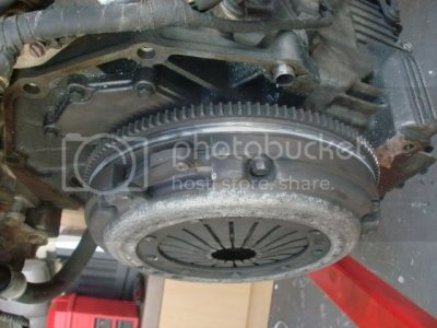

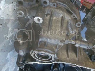

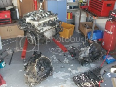

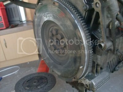

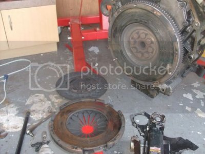

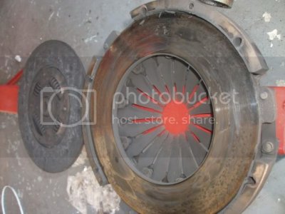

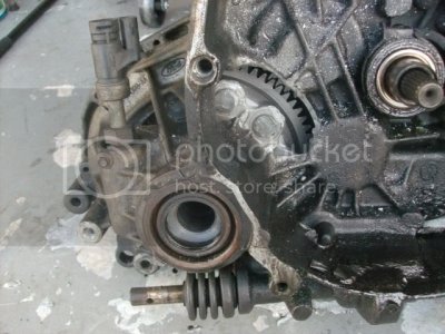

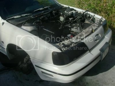

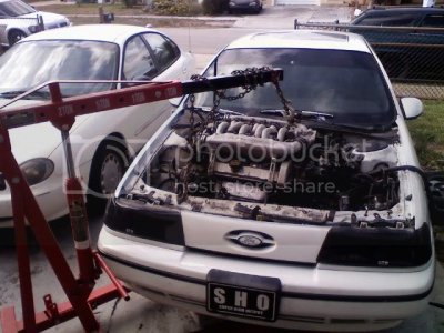

GOT IT!!! Nothing busted, was real real careful, just scratched a brake line but didn't burst. Will look into later, now for the pics...
