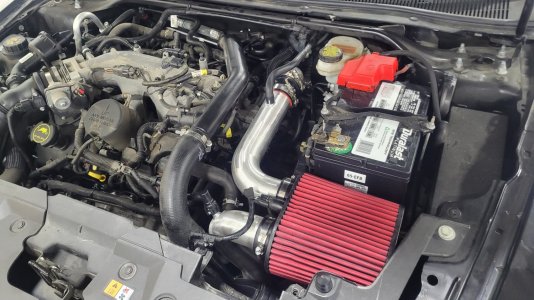

Didn't do it today but got my EPP intake in last week. Been recovering from Hurricane Ian (Cape Coral, Ft Myers area) and also preparing to move back the **** to Michigan. (Been here since Charley and this one finally did me in.) Debating rather or not I'm gonna put the box in because I seriously love the intake as it is in there. Also had a Post-Hurricane detail done. Had a couple light scratches from debris but they buffed out.

I highly recommend the box. It is designed to block heat/hot air from the filter. It does not take away from the filter appearance as it is below and around the sides of the filter. Also, I recommend the Hot Pipes. They are the ones more likely to be damaged by boost.

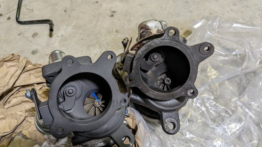

Installed my turbobay performance turbo's this past weekend along with new coolant and oil lines. Ugh...what a nightmare. Both oil drain lines were corroded in place. Took a lot of time, effort and persuasion to work them free without breaking them in the engine block. Then the front coolant lines run under several sets of wiring harnesses and vacuum lines to the rear which were nearly impossible to replace. Several of the exhaust bolts broke and had to be drilled out. This I did expect to be fair. Definitely want to get steel bits designed for hardened steel and some cutting oil to save time.
No leaks ! Woo hoo! Now to get the tune dialed in.
One good thing I found was the rear turbo may be removed without pulling the passenger side driveshaft. It's kind of like solving a puzzle, twisting, rotating, spinning to get it in. Takes some time to figure it out.

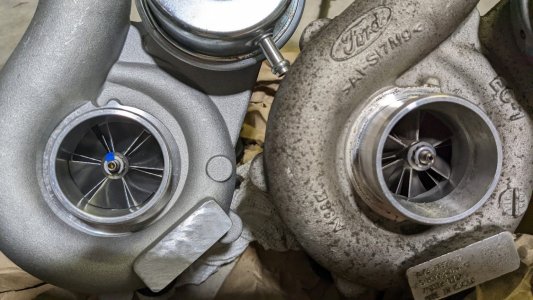

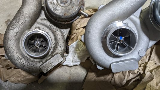

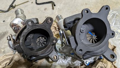

I was surprised at how much larger the turbine and compressor wheels looked in person. The old turbos were actually pretty healthy with 110k miles on them. No real play on the shaft and spun freely. Crazy how small the stock turbine wheels are!! All the exhaust has to flow through that !? Well of course until the waste gate opens.
