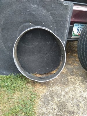

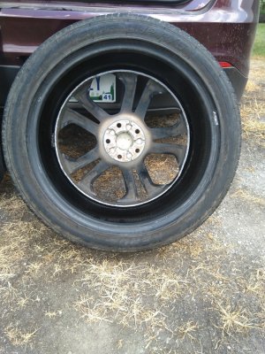

I hit a p o t hole from hel l. And for the first time in my life got to see what a rim looks like split in two.

Ouch, what's the damage other than the wheel?
I couldn't have been luckier on that. When it sperated, the strut prevented it from going anywhere, it gouged the struts bolts and scraped the strut. But the fender liner and everything else was untouched. When I picked up a new wheel today at a Ford supplier in Indy. They informed me that it's being sent back to manufacture because they have never seen anything like it. The tires only had 500 miles on them. I had road hazard. My tire store put on the new tire and mounted for free. Course the wheel cost me 600.

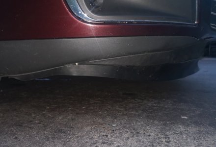

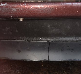

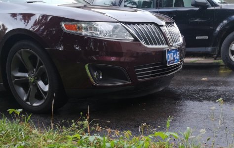

Okay another one of my "I got board stories".
The last few days I've been thinking about weight savings and engine compartment air flow.
So the MKS underbody panel, between the nose and the radiator cross member, is significantly lighter than the s h o panel that I've been using. We're not talking pounds we're talking maybe a couple ounces. Neither weighs very much. The front air dam is molded into the plastic with the MKS. So I decided to go back to the MKS panel.
The other thing on my mind was airflow through the engine compartment is a little slow with the underbelly pan mounted. I figured that the air flowing underneath the pan was too high pressure. So why augmented the air dam in the MKS panel with the flexible air dam skirt from the SHO panel. This should reduce the air flow underneath the nose of the car (lower pressure) and should draw more air out from underneath the hood (higher pressure).
Anyhow I mounted it all up and went for a drive. First thing I noticed was the front of the car felt a little heavier, due to the due to the slight air pressure decrease.
Second thing I noticed was that my engine temperature had dropped 10° to 12° f while on the highway. The gear Head intercooler didn't show any improvement though in IATs. Normally I'm hitting 210°- 215°f engine temperatures on the highway. With the extended air dam I was reading 196 to 198°.
Here's some pictures of my hillbilly air dam.
