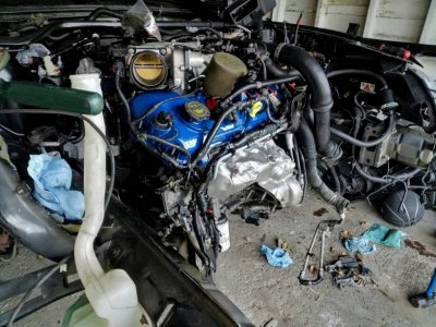

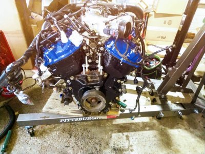

Wow what all was done

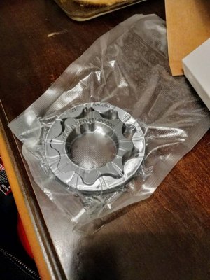

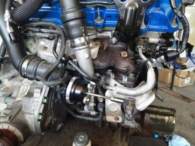

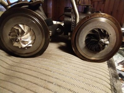

Timing chain, guides/ components, water pump, billett oil pump gears, new timing cover (motor mount punched hole in accident), Painted timing and valve covers, new front turbo oil feed line and quick connect fitting from head. Repaired broken HPFP connector. New Msd coils, all new turbo and valve cover gaskets, oil pickup seal. ReInstalled my upgraded turbos, replace front cover of rear turbo from donner (outlet port snapped off in accident)8a23babcc3d0477d55795f0e3a6a330a

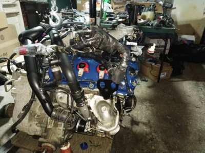

54
C374b153f34c6baa81260340c1e7b5d6E635c8e9ae7ed7865c0ac4c27456d12eAf63814f0fe10e2f5431779a2aa685cb
Damn you've been busy looks like spaghetti to me Great job.....

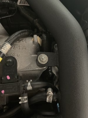

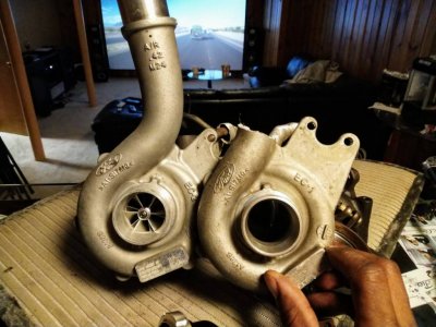

EPP Hot Pipes installed.... Firestorm HPFP sold off... new XDI pump incoming tomorrow or Friday... off for GH turbos and EPP catted downpipe install on Saturday... pickup and dyno on Wednesday...
EPP Hotpipes install was OK at best... requires A LOT of adjustments to get them straight... this I believe is due to the this tab not being welded on in the correct place.. there is enough slop in the couplers to adjust them.. but still...

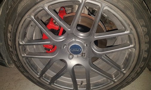

Weather finally cooperated, removed the Winter tires, lubed the rear caliper pins and replaced the front ones as the boots were torn. Painted the rotors to get rid of that ugly rust appeal, painted the calipers, drained the transmission and replaced 5 liters of fluid, pushed the exhaust back in place as my daughter had "re-positioned" it after going over a curb.
