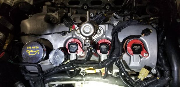

LMS catch can. anybody know what side gets the open pipe and what side gets the brass filter? Nothing in the instructions. SOOOOoo I put the open pipe side to the valve cover and the brass filter to the intake plumbing. anybody know?
That is correct. You want the air going to the intake manifold filtered and the drip tube on the PCV valve side.

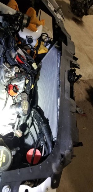

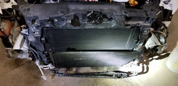

Made some progress at the shop today (finally).
After 3 attempts from the Ford stealership sending incorrect radiators, 3rd time was a charm.
As such, was able to get the Gearhead Intercooler installed today, as well as the new/fresh set of SP534 plugs, and new coils from MSD.
The latter having turned out to be an issue because despite my wiring harness depicting a 3-PIN coil (which I previously ordered last year) turns out they were actually 2-PIN Coils for my model year. Ugh. Go figure.
Anyhow, slowly but surely.
Oh and btw, the new IC from GH..... goodness Christ the fit and finish is simply phenomenal.
I mean spot on fits like a glove. No F'n around. Pull out the old OEM one, drop in the new one, and wallah.
Just true, true piece of craftsmanship. Bravo!9f1c7803faf316aac9fb52761d83424fE332027e31d53ee1cf3c9ebf713a53c637aa478c6009cc889e8fa023d8382bd6

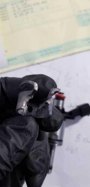

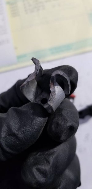

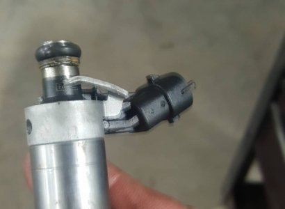

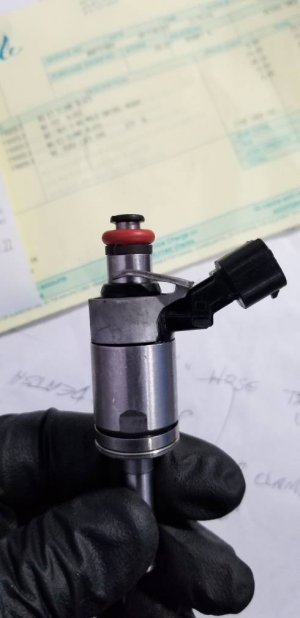

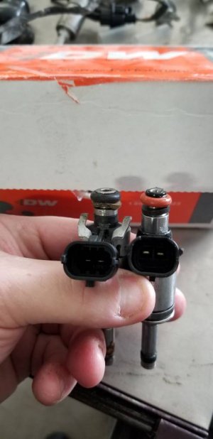

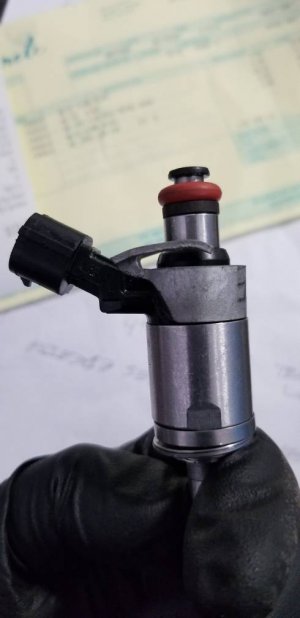

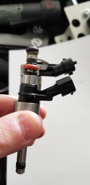

Well, after getting the right radiator, the GH IC & MSD Coils installed, we attempted to move onto the new, upgraded fuel injectors from DW.

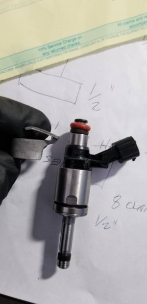

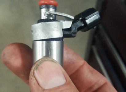

And then we hit yet another snag. Seems like we've had nothing but delay, after delay. So the wiring harness was/is at a different angle then the OE Injectors. The retaining clip did not seat properly, and finally the connector wouldn't plug in, and closer inspection yielded the pins do not match.
Ugh. So after several phone calls, emails that included pictures, and get the chief/lead engineer from DW involved, we learned that there is an applicable adapter harness for the 2010 model year, which we were not aware of, and nor is advertised on their website.
DW is doing me a solid though, and is air shipping out the adapters to me, free of charge, for all the hassle's incurred. Which was/is very cool of them.
DW Injector has the orange nylon o-ring. The OE Injector does not (for visual differences in the pics).
Spent Saturday in front of a grinding wheel, and I ground down what I needed to on the steel retaining clips, to make them fit and seat properly. Fun times!

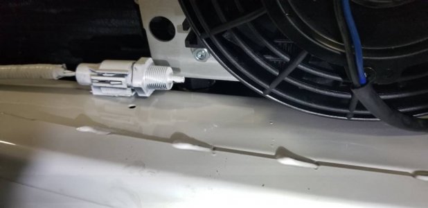

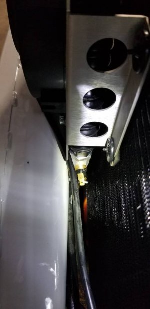

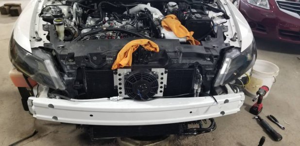

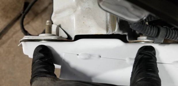

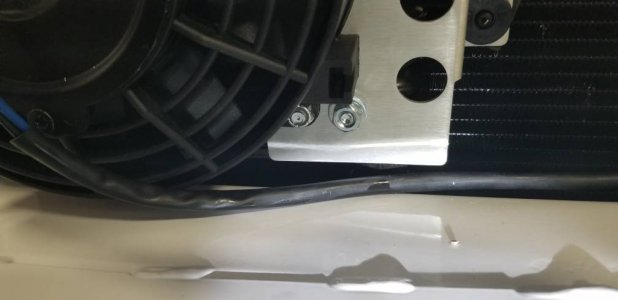

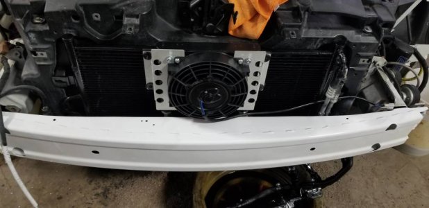

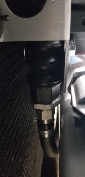

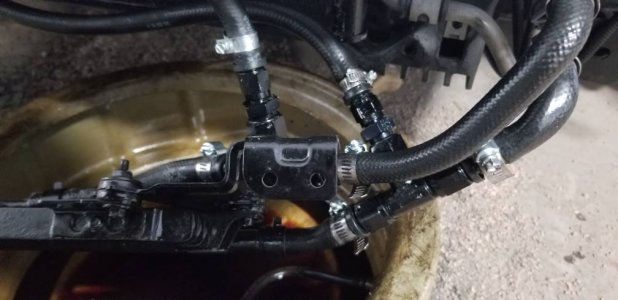

Also, we got the front crash bar re-installed, as well as the head assemblies, and more importantly the new aux trans cooler from Derale (with fan). Had to purchase all sorts of fittings, and a switch to run into the interior/cabin. Started the wiring on that as well.
Very, VERY CLOSE FIT! Like this/close! In order to provide just a tad bit of breathing room, we installed a single washer between the back side of the front crash bar, and the front side of each frame rail.
But all in all, she's resting well in the area just atop the crash bar.
Pretty much it for now. More work set to occur for this coming week. Stay tuned..... 96cfcfbdfa3db0419720bf9e76d09b9d3719ceb1906e167e7f3cb7778dbbbbaaCecd327d31d2860ca0ba31ca50a3bca8Eb855fff19db19a57143024e8abd0a9a9ce3bf0708eb8450d481c56cf2917d8e619f7d674995f66443aae0f04e130b9804dd3d6ef08580087ea91b5a4bdd0609Ae2315056a81302d7ad4062d5a8b9d085f1104ca4de0dbc6a46baf03fe788907

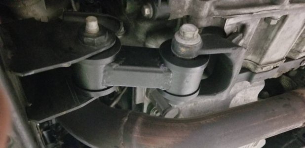

New upgraded/hardened Trans Mounts

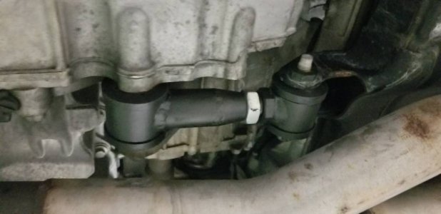

Here's a short video link, which I think will work, along with a couple of pics of the new trans mounts.

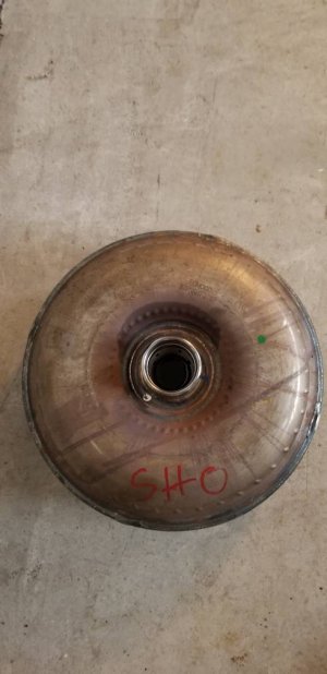

Finally, I snagged a fully functioning torque converter for my 2010 (which has 4 bolts, not 3 like most other model years) from a SHO he parted out. I'll be sending this off to GH for modifying/fortifying/upgrading etc.
Even more great times await! As always, stay tuned..... !
