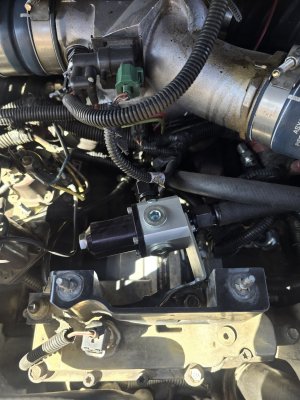

When I had my injectors and fuel system installed, we could only get the fuel pressure up to 55 psi. I am running a double regulated system. One regulator on top of the motor at the fuel distribution block.
20260415 151112
The second regulator is on the AirDog.
20260415 150741
This was down from the the 65 psi from stock. However, Full Force Injectors have a window for pressures to work properly. That window is 55 psi to 65 psi. So at 55 psi, technically we were in the window. So I went out and messed with the return regulator on top. I messed with the jam nut, and was able to run the pressure up to 70 psi. Locked the jam nut on top, and then I went under the truck to the Air Dog and bumped that regulator down to 65 psi.
With the injectors and fuel pressure set at 55 psi, the truck ran really good. Lots of power and very little smoke. It was rare the EGTs ever went over 1250 F even pulling a heavy load up hill. On the Andrew Arthur tune (I call it The Do it For Dale Tune, because I put it in the 3rd position in my Hyrda) at 40+ psi of boost she is rolling, with EGT's of 1050 F ish, and very little smoke. I have AA tunes and Gearhead Tunes.
Now at 65 psi it is a completely different truck across all of the tunes across the whole powerband. On the "Do it for Dale Tune," it probably picked up another 40 to 50 hp, and at least another 100 lbs of tq. At 40+ psi of a boost I feel like Space Ball One. Shit is going PLAID! Except, there at 1200 F EGTS, quite a bit of smoke, and now I am really starting to consider brake upgrades. When towing almost 21k lbs, the brakes are great. Getting Betty down from 100 mph is different story.

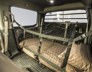

At what point is the ease and convenience of having an in bed camper too much. That would make me more nervous than pulling a 40' 5th wheel on single rear wheel set up.
I personally like how the hotshot guys do it, convert the back seat into a bed. Beyond that a camping stove and a roll of toilet paper is all you need.

Might be a little cozy for 2 but not impossible

Keep most of the bed, keep the cab, just enough for sleeping, perfect. If I ever got into a 450/550 I'd do hotshots in a heartbeat.
