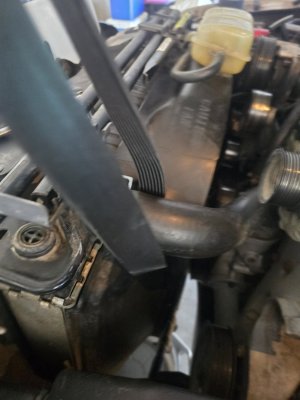

EPDM belts don't crack. You've got the new belt, use it. You don't want to be on the side of the road changing a belt or worse, repairing the damage from a thrown belt.
So I replaced the belt. It was in decent condition. Good enough to be a back up if needed. However.......come on Ford.
20250829 084840

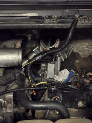

That was the only hiccup. Drained a couple gallons of coolant, removed hose, swapped belts, put the hose back on, poured the coolant back in and sent it.
I was also able to install the passenger bank EGT sensor.

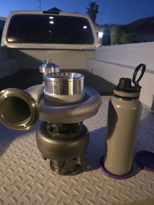

F450 Update: KC Turbo called me Friday around 3 pm and said my order was ready. So I drove down and picked everything up. The guys are KC's are amazing. We BS'ed for about 30 mins and then they took me on a tour of the facility. Super cool guys.
So on Saturday I started the process of replacing the turbo, pedestal, and bellowed up-pipes.

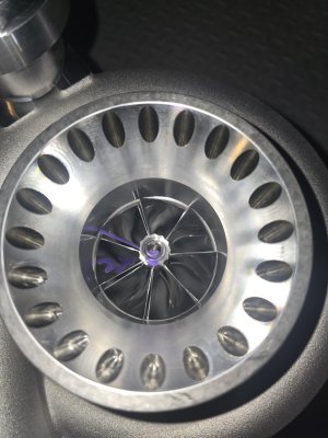

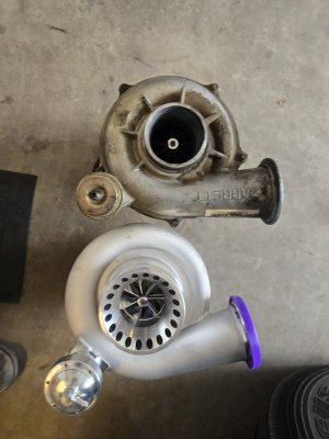

New Hotness:
20250905 191552
20250905 191610
Compared to old trusty:
20250906 170309

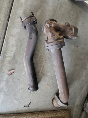

The tear down wasn't bad. IC piping, removal of the spider, downpipe, and turbo disconnect wasn't bad. What was bad, was the removal of these bastards.
20250906 170314
These up-pipes were leaking, and bad. The nuts and bolts are seized (because they have a million heat cycles on them), I rounded off bolts, used fire, used the death wheel, and ultimately started just breaking off bolt heads. Got the new up-pipes (they weren't too bad to install) in. If I ever do this again, I 100% will remove the cab. The up-pipes are jammed between the engine and the cab. This job took me 10 hours, 6 hours of which were the damn up-pipes. If I removed the cab, the whole turbo swap including the up-pipes would have been about an hour.

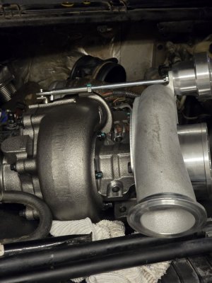

Next was the pedestal, and upgraded turbo to go in.
20250906 185702
Finished up re-installing the hotside and coldside. Used the non-start function on the Hydra Tuner to crank the motor over to build oil pressure to the turbo. Started the truck and let it idle for about 10 mins checked for oil leaks. No leaks.

F450 Update: So here are my first impressions of driving the new KC Gen 3 Stage 1 turbo. First things first. I love this truck. Even with the old turbo, leaking up-pipes, down on power, I love this truck. It might have been a complete tractor accelerating, clunky, bouncy, and overall older but she is mine.
That being said. If I just had replaced the old up-pipes with the bellowed ones and got rid of the exhaust leaks it would have been worth it. However, coupled with the new upgraded turbo it completely changed the truck. It makes new super cool turbo noises (that is a huge deal in my book), it spools quickly, and Ol' Betty dare I say at over 10k lbs actually accelerates kinda like a modern truck. No more exhaust ticking, just straight beautiful 7.3 Powerstroke symphonic bliss, and KC Turbo sounds. What a difference. The bump in power is really nice too.

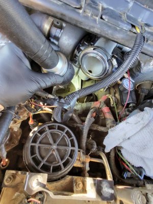

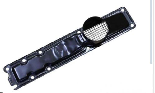

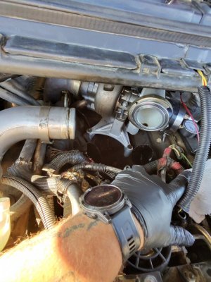

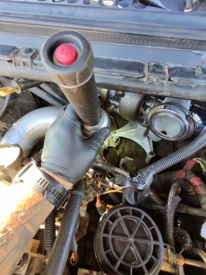

Ford F450 Update: So I hooked up the boost leak detector and there were many boost leaks. Four of them to be exact. I worked through half of them. However, I guess when I installed the turbo, I didn't realize that I bent the intake inlet connectors.
Opera Snapshot 2025 09 18 102020 wwwgooglecom
Here are some terrible pictures of how I wrecked them....lol.
Crushed 1
Crushed 2
I tried to bend them back and re-install the lower couplers, but to no avail. They were too compromised and would crush when I tried to tighten the couplers down.
Kinda fixed
I purchased a pair of billet intake inlets and new couplers. That will be my project this weekend. I also bought a topside creeper, so no more laying on the top of the engine for me. Unfortunately, the turbo has to come back out.....good times.

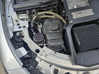

E63 Update:
There is documented issues with the PCV system on the M177 LS2 engines that are in the E63's. I have had all of the repairs done to eliminate the issues, and now I am adding a these catch cans to help. I think I am the fourth person to add these to the platform. They fit well and they look great, hopefully they work just as good.
Cc1
Cc2
I need to go back in and re-clean the engine bay because it is filthy. I have also removed the BMC filter.

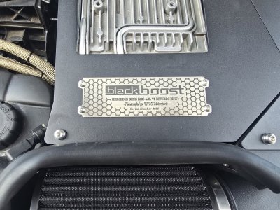

E63 Update:

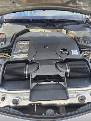

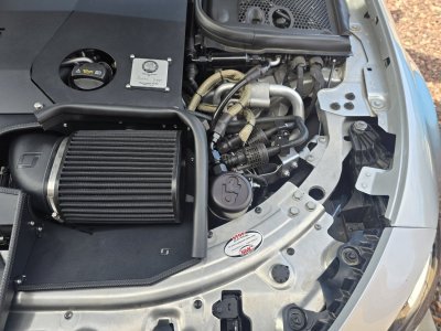

While she was getting the catch cans installed, I had them install the Gen 2 Black Boost Intakes.
Bb1
Bb2

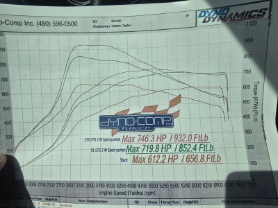

I also had Dyno Comp give me a E30 tune as well. Here is what she cranked out......
DCE30 Tune
I was a bit un-easy with that much tq. They turned it down to 737/881 I believe. I have the dyno sheet, I just didn't take a picture of it. I can't wait until it cools off and I will get to see the new draggy numbers.
