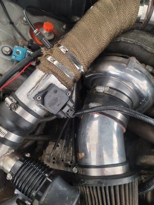

Before I sent it to the shop, I did heat wrap the charge pipe that crosses over the hot side of the engine. Since it is only going to be 106 today, I am planning on mocking up the pre turbo water sprayer today as well.

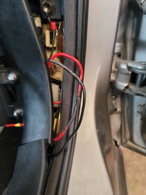

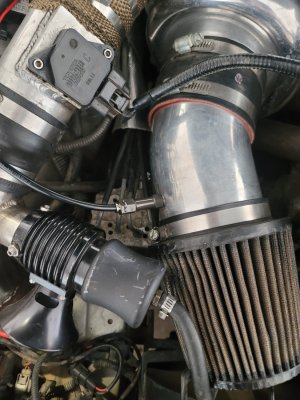

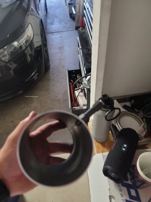

Lexus Update: Alright. Here is where I added the nozzle pre turbo. Just drilled and tapped 1/8 not and ran the nozzle in.
20230818 183926
20230819 102213

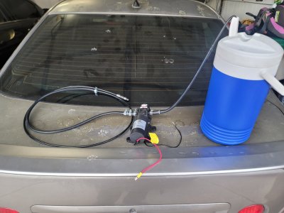

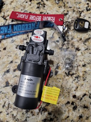

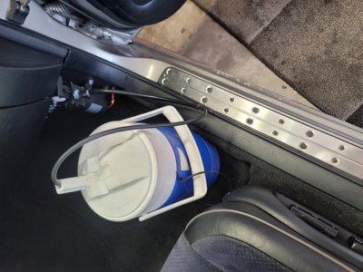

Next was mounting the pump and running the line to the engine bay. I drilled through the fire wall above the passenger side wire loom with same size drill bit as the hose. It was a tight fit but it worked great.

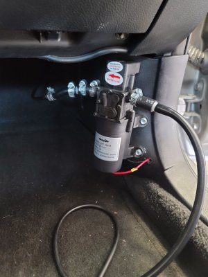

Mounted the pump to the kick panel. Yes there quite of bit of fittings. I will fix that in the future.
20230819 113301
Next I soldered wires for the ground and power to the pump from the activation button.
20230819 111920
Next, I just add the hose through the top of the igloo thermos and secure it to the seat with a zip tie.
20230819 113333
I did relocate the AEM nozzle to the charge pipe post turbo. I will run that tonight and try to get some data. Probably buy another nozzle kit like this and add that pre turbo with the smallest cc jet I can get.
20230819 103156

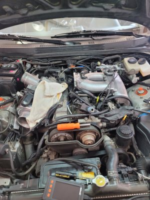

I also went and pulled the plugs out of the engine and took my bore-a-scope and check out the pistons. Plugs were good and the pistons are doing great.
