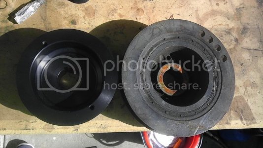

also new underdrive pulley from SHOSOURCE (thanks for super fast shipping), stock pulley has the rubber part all cracked on some areas and beginning to separate.
IMAG0512 zps909c5eb0

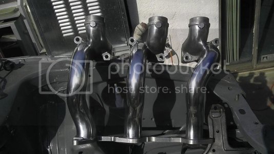

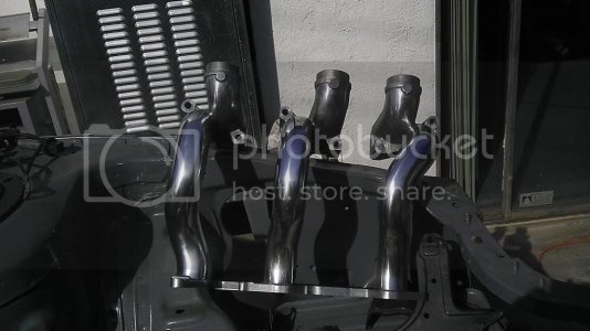

OK, let's see that bling!
have not yet polished the runners but they both sets look like this after getting hit with sisal wheel and black compound. (cant wait when i get to the polishing part) after lots of sand paper.
IMAG0513 zps9c5fb28f
IMAG0514 zpsdcfd0826
im about to begin doing the secondaries and everything that looks not as shinny.

As an FYI, the guys that do my polishing for me, use just 10" cotton wheels and flap wheels. They took a flat spot on an intake piece (rear plenum) from raw to highly polished in about 30 seconds. The difference is the rpm of their wheels 3400 rpms, and the amount of force they can put against that wheel. The motors that drive six wheels (3 work stations) are big 10 HP, 3 phase motors.
My home polishing motor is 1/2 hp with 6" cotton and it takes forever.

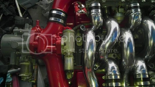

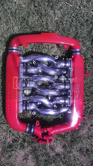

little update... went with this color combination to match rest of engine. red tanks with polished runners
pic is from cell phone
IMAG0533 zps86c619b2
i was going to polish the tanks but they will get scratched easily due to them touching/rubbing hood.
this polishing stuff is a mess, lots of dirt/wax/ pieces of buffing wheels all over, not fun... it took me 4 days to finish the runners.

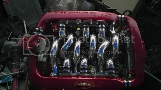

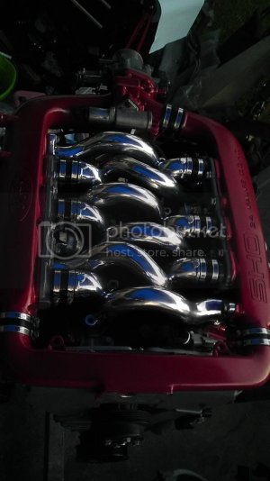

and some more
here the intake can be seen on engine with the IAC valve without the spacer, heater thingy, I did not want to have a mess of little hoses that will only heat up the intake.

this is one of my favorite pics, i will retake them with the DSLR i have, but the effect is there this intake looks pretty even at dusk.
