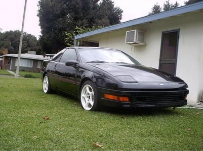

here is my current setup
5061750056 large
http://www.cardomain.com/ride/506175/3
im still a member of probetalk and the tcca, i did one of those sticky post about the vulcan engine and mods for it on pt and had a huge post about about the built of the car and engine in PT and TCCA. i like my setup a lot....
but again i have always been a fan of the SHO
i know the SHO will bolt right up to the transmission i have, i actually have two of them one for back up. the only issue i can think of right now other than the custom mounts (easy to do and have a friend willing to cnc some for me for very cheap) and the custom driver side driveshaft (which will not be that expensive anyways).
since this is a non california sho engine, i want to know what are my options for the ECU and the LPM tuner. i dont wanna spend much right now on this part since i have limited resources and want the car to be fairly reliable and be able to act "stock" meeting that the stock dash board will work fine with the ecu. which will not be that hard in my opinion, only need to wire the warning lights and sensors the sho computer since the speedometer is mechanical that will not be affected.
thanks for your comments and ongoing help
btw i was not aware there were more than 1 running sho swap into a probe already, do you guys have links???

there has also been a sho engine put in a 626,same platform 626 as your 1g probe.
digging the white fds! i have a white 2g pgt and i've been toying with the idea of white rx7 fd rims...you sealed it for me!
iirc you can find info on the sho/probe swap on pt,the guy was from upstate ny,so maybe look in the nypoc section? or 1g performance section
