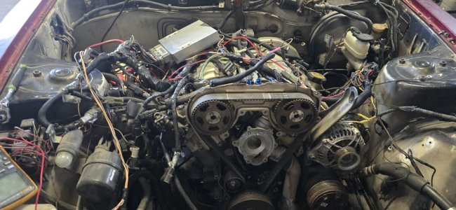

Well that sucks well any other ideas? To use the oem motor mount? The engine bay looks like this with the engine in it10000577291000061479

The AC compressor is indeed a support for the motor mount and alternator in a stock application.
In your case, you can remove the compressor if you can design and engineer a motor mount to effectively support the motor. It has been done several times.

So i can take the the compressor off and use the holes to make up a motor mount
