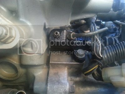

update, I realized i have not shown what modification needs to be done to transmission to clear the rear seal of the SHO so here it is
WP 20150103 003 zpsaf531334
and today I put the engine/transmission back in car, now its just a matter or reconnecting everything in engine bay and hopefully it will roar back to life pretty soon again. I did cover all of the holes on engine because i left it exposed to elements tonight

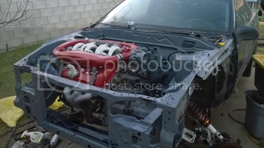

soooo after a few months of sitting and waiting for attention.a little sneak peak
WP 20150809 002 zpsoy24okda
and
WP 20150809 006 zpssb4xrnzd
AN hoses, connectors, remote oil filter, to add bling but done out of necessity to clear radiator,
will post some updates soon as this thing has to be running within 2 months tops.

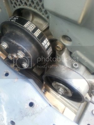

got a 29 inch belt no tensioner, belt goes around water pump and crankshaft pulley it fits "tight" it should be ok to drive water pump.

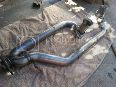

Off Road SHO
Moderator
Jan 16, 2002
5,684
1,292
No real reason to weld the slip joint IMHO, not much exhaust is going to get through that joint and it acts as an expansion joint if not welded.
