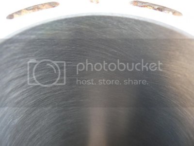

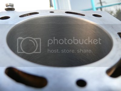

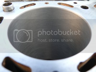

I got to honing all the cylinders in the engine. I used a flex hone, 89mm, 240 grit.
Did the standard clean work area, floor around, etc, etc. Then i got engine oil 10-30w to coat each cylinder and coated hone with it too everytime i did a cylinder.
cleaned each cylinder with shop paper towels (blue ones) to check for results, if not satisfied I repeated process above until satisfied.
here are some pics so u guys can see the results,
P1160520 zps630a7a80
P1160522 zpse6748f24
and close up
P1160525 zpsf60d37b3
please note the pics are after i cleaned cylinders with lots of hot soapy water, terry cloths, transmission oil and more terry cloths, until cloths did not have any dirt and everything was dry, then i did a light coat of transmission oil at the end to make sure cylinders don't get all rusted.
as usual any comments are all welcome.

That closeup looks great! It appears you achieved about the same angle as what was on there before. Thanks for including some details. I expect to be doing the very same thing this weekend or next.
What rings are you going with?

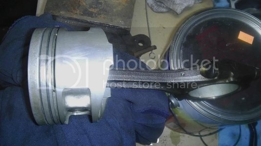

began to clean pistons...
before DSCN1846 zps1cad3ff0
after
IMAG0474 zps659987b7
:munch:
BTW what does the big 23 imprinted on the piston top means??

How did you clean out the grooves? Piston Ring Groove Tool? It is very important that the ring grooves be free of ANY carbon buildup so that the ring can move in and out freely.

To clean the pistons i been using some simple methods, lets all remember this is still a budget build.
IF ANY OF YOU USE THIS METHOD BE SAFE, ALL THE CHEMICALS ARE BAD FOR YOU, DO NOT SKIP ON SAFETY AND DON'T BLAME ME IF YOU ARE CARELESS.
The tools are:
toothbrush
Broken old piston rings
lots of paper rags (blue ones)
some terry cloths
disposable rubber gloves
safety glasses.
plastic containers
And the Chemicals are:
water
wd-40
Brake cleaner
Berryman Chemical Dip (the big bucket it has a little handy built in drip tray)
Berryman B12 (two cans)
the way I do it is by cleaning the piston with paper rags to remove lose stuff, Then i put all the Berryman B12 in a little plastic container (big enough for piston to fit) and put piston upside down so the carbon gets soaked for 30 minutes. after that i do put the piston into the Chemical Dip and let it sit for about an hour in there. these two loosen and dissolve most of the crap off the piston and its groves, from there I use the toothbrush and the old broken piston rings to remove the carbon buildup which at this point is mostly sludge.
It is time consuming but it works, the gloves and glasses and other stuff used for protection from splashing of chemical is a must since stuff will splatter all over when brushing. After all this is done i use water to rinse them out one last time, dry with terry cloth, spray with brake cleaner and when that evaporates, spray with wd-40 so it does not flash rust, since its going to be a little while before i assemble everything again.
The piston tops where the valve reliefs are still have some carbon buildup. I'm thinking of using a brass bristled wheel and a dremel or drill to clean that off since the brass should not scrape the piston top.

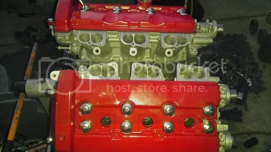

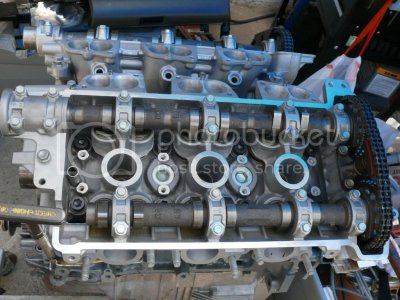

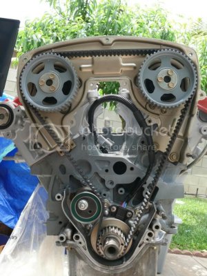

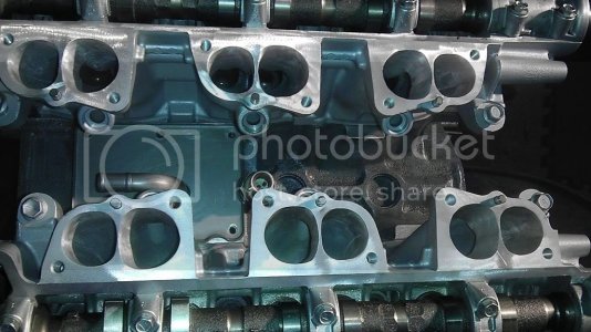

sooooo here are pics of engine stuff...
rebuild heads back on.
P1160602 zps8654a9ac
some gasket match porting.
IMAG0507 zpsdd559e75
some color

timing set

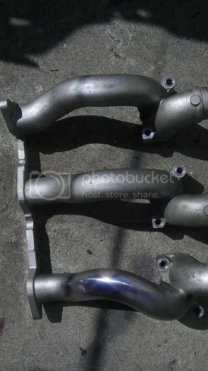

Oh and also, polish something on the engine.
Tom
Hmmmm......
Challenge accepted !!!
:salute:
this spot took like 5 minutes or so to do.... I think I need some music to listen to, cause this is going to take a while

Five minutes there = 45 minutes in the nightmarish folds and curves where they come together at the heads. :)
The runners are dead sexy when polished right, though!

yup I will need a few more buffing wheels because of those little areas... and a chair
Off Road SHO
Moderator
Jan 16, 2002
5,684
1,292
And a lot of beer. I'm sure you already know this but wear a dust mask when polishing any metal, especially aluminum.
I use green bar compound I get from the jewelry making supply house. Also got the buffing wheels and the quick disconnect wheel holders there.
Tom
7,522
my experience is its more like 5 minutes on the easy stuff = 5 hours on the hard areas...
