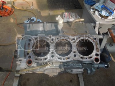

Soooo after much debating i took off the heads cause this engine has been sitting for a little bit over 2 years, when i did the rod bearing i did notice some oil coming out of a spark plug hole.....
so here is what i found.

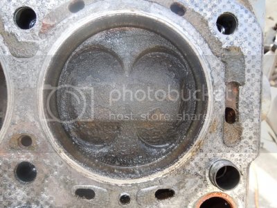

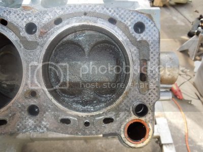

first for reference
on this picture you see cylinder 1
DSCN1843 zps39aa55df
DSCN1842 zps59b96c97

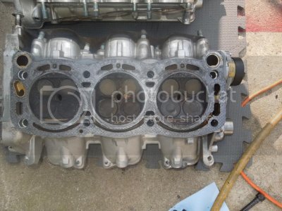

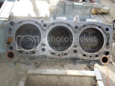

and the head corresponding to it which cylinder from left to right 3 2 1
DSCN1840 zps01d2f8b6
and the rear bank of cylinders from left to right 3 2 1
DSCN1837 zps4ae639ad

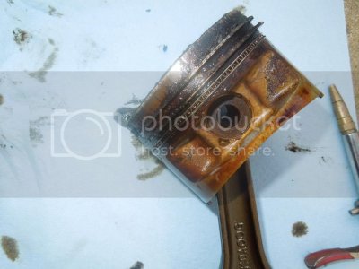

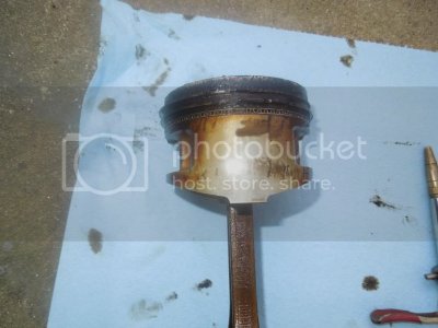

and the piston from cylinder 1
DSCN1847 zps8060329a
DSCN1846 zps1cad3ff0
also for front cylinders
DSCN1836 zpsee5d4689

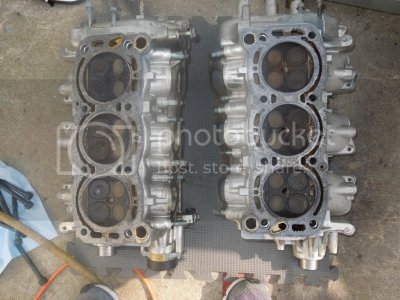

and both heads
DSCN1838 zps4b115773
soo what do you guys think?? i think its weird that only that piston/cylinder shows that much oil, the other cylinders have oil too but not as much, so im thinking of soaking the piston assembly on cleaner to make sure rings are clean and not sticking, and well since im already doing this, i might as well do the same with all the other ones and clean them too.
any opinions ??? does it seem engine was running good/lean/rich? should i do something else??
thanks for your time

Yeah,
You should have a complete valve job done, the cylinders checked for too much taper and if they are within specs, ball hone the cylinders and new rings.
Oh and also, polish something on the engine.
Tom
7,521
at least the rings are not completely stuck - I have taken some apart where the rings don't move at all.
you need to soak in parts cleaner until you can get the rings off, and clean up pistons, rings, cylinders, etc.
pay attention to the rings, there is a top side and a bottom side to both compression rings and you don't want them upside down when you reassemble.

i think only the bottom control ring is kinda stuck the upper 2 move fine
does anyone still sell the piston rings?? autozone and o'reilly dont have them anymore... :munch:

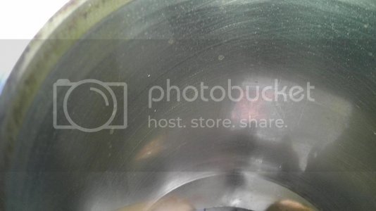

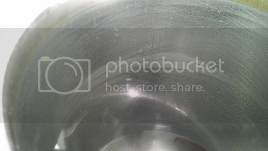

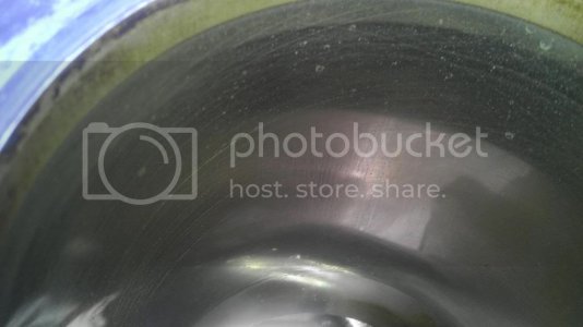

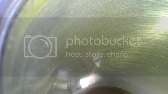

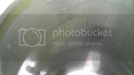

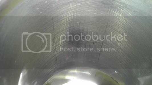

getting ready to hone the cylinders i think a ball hone will be the best choice for this engine, it still has the factory cross marks and very little wear, so im guessing a light hone will work.
i was thinking of using the hone oreilly rents but those are the square stone ones and i feel they are harder to use and get good results.
only 2 of the pistons had the oil control rings kinda stuck so all pistons are going in cleaner soon.
probe_racer
Nov 7, 2009
147
58
california
here is a pic of cylinders ready to get light hone on them.
cylinder 1
IMAG0412 zps038212aa
cylinder 2
IMAG0414 zps61bf65a3
cylinder 3
IMAG0415 zps81c451ab
cylinder 4
IMAG0416 zpsaaf6ecf9
cylinder 5
IMAG0417 zpse068a48c
cylinder 6
IMAG0411 zpsa9b8ae16
i will use a ball hone and will add new piston rings. everything should be here by next week or so.
any input as always is very very welcome
7,521
make sure you check and (if necessary) set the ring gaps on the new rings. you do not want the ring gap too tight.

Those cylinder's look pretty good. I would not hone it at all.
7,521
I would do a very light hone - there is a shiny spot where nearly all the cross-hatching is worn away in the center of the stroke - typically this will be on both sides of the cylinder perpendicular to the wrist pin. you need some cross-hatching for proper oil control.
