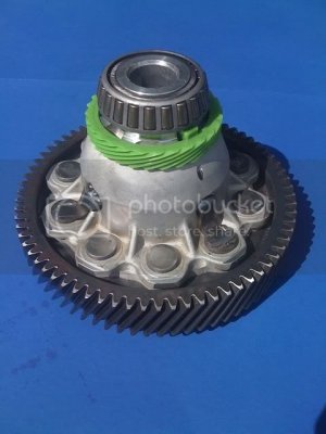

Any other transmission work I should consider at the same time I do the clutch?
Have the differential reinforced. If you can't pull it apart and have to have a shop do the work, print out this picture and have this done to all four pinion shafts.
IMG 0189

Thanks again- Got my list and will start collecting parts. the pic's a big help 2 TYSHO.
